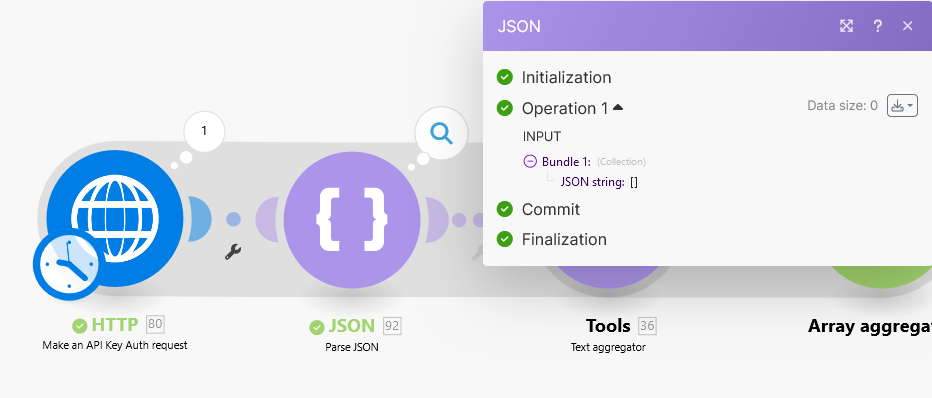

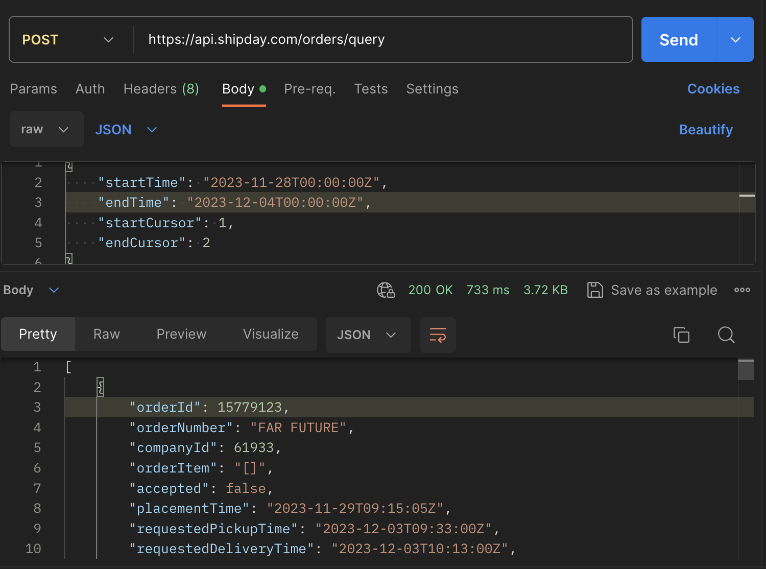

No luck here either:
Running it through Postman shows that it is working correctly, however:
It’s a tricky one!

Hi Aidan,
Do you happen to have the Integromat Chrome extension? It can help you see precisely what data you're sending and receiving in responses. Could you also examine the response headers for any extra information?
Based on your screenshot, it appears you're receiving an empty array. The most likely reason is that the request parameters aren't being sent in the expected format, leading the query to return no results.
Posted : 30/11/2023 6:56 pm
