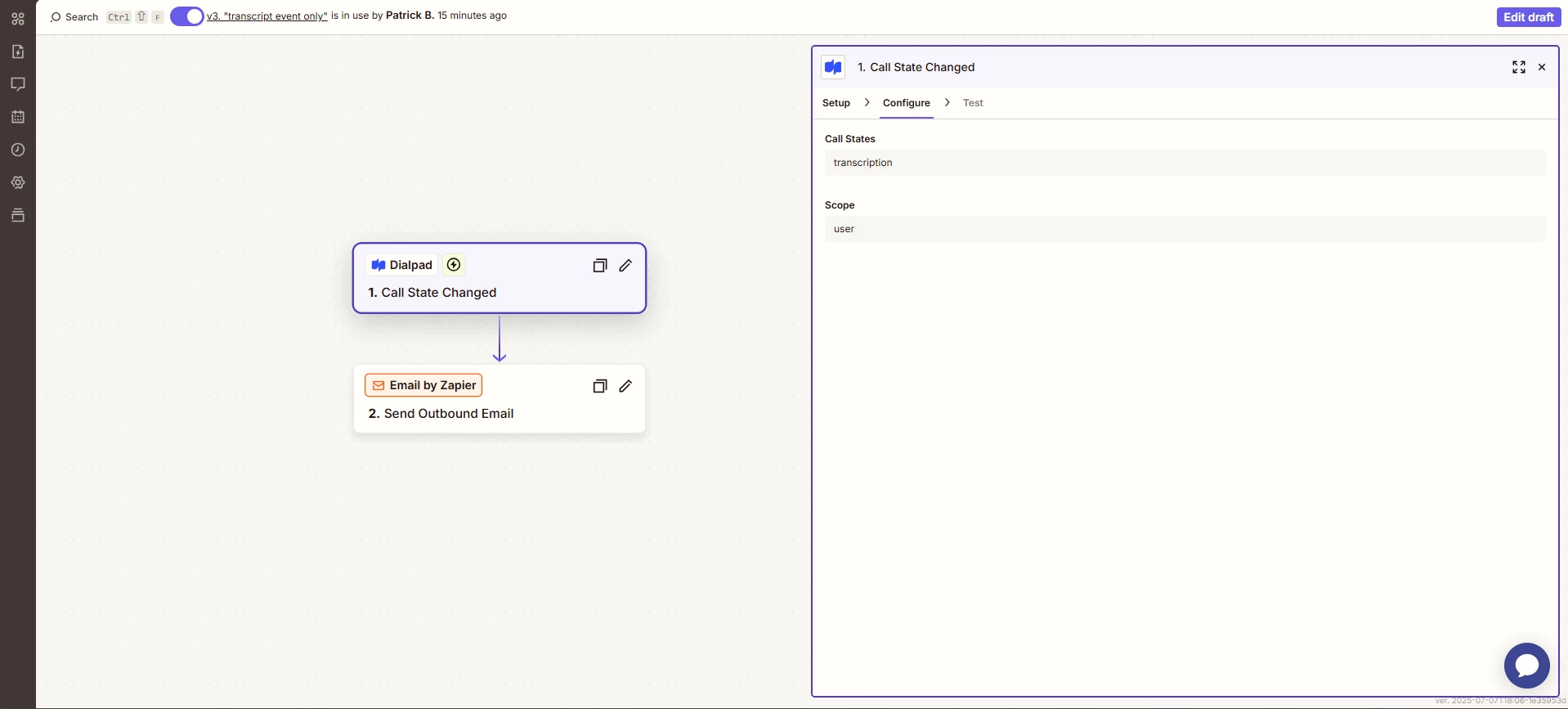

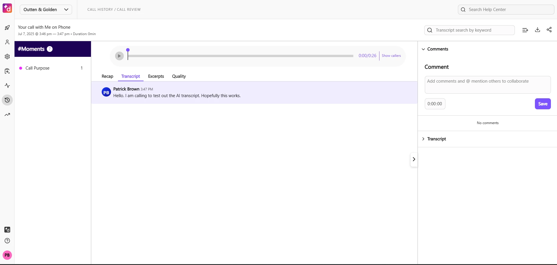

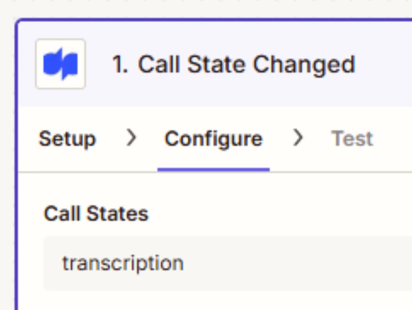

My callin.io workflow that I've  created, intended to trigger on a call event "transcript", is not running when the AI transcript is generated on Dialpad.

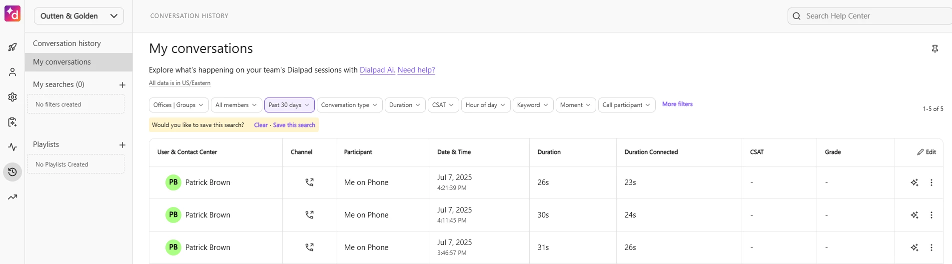

These are test calls with AI transcripts that I’ve conducted for testing.

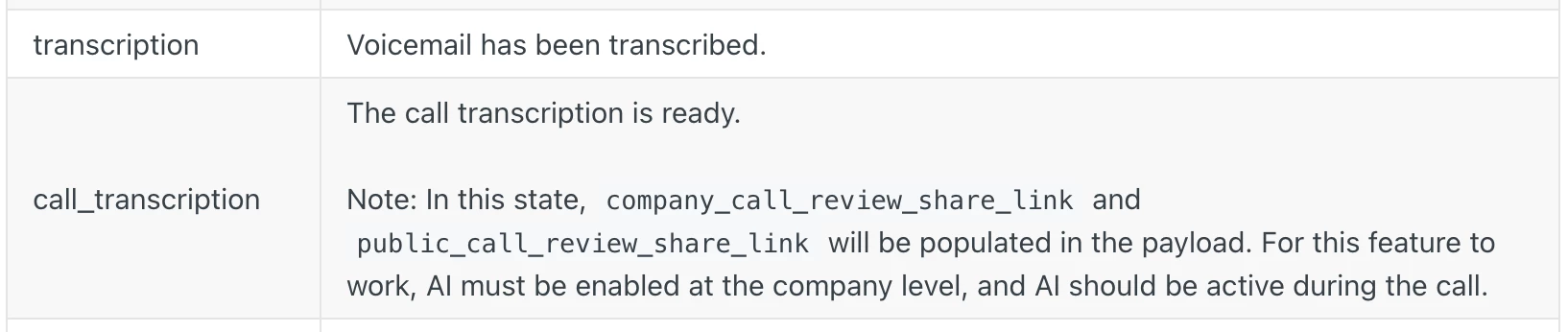

The “Transcription” call state seems to differ from the AI Transcript you are anticipating.
Please check the list of Dialpad call event definitions:
https://developers.do.com/docs/call-events#call-states
Posted : 08/07/2025 12:00 am

Modify the chosen Call States within the callin.io trigger step settings.
