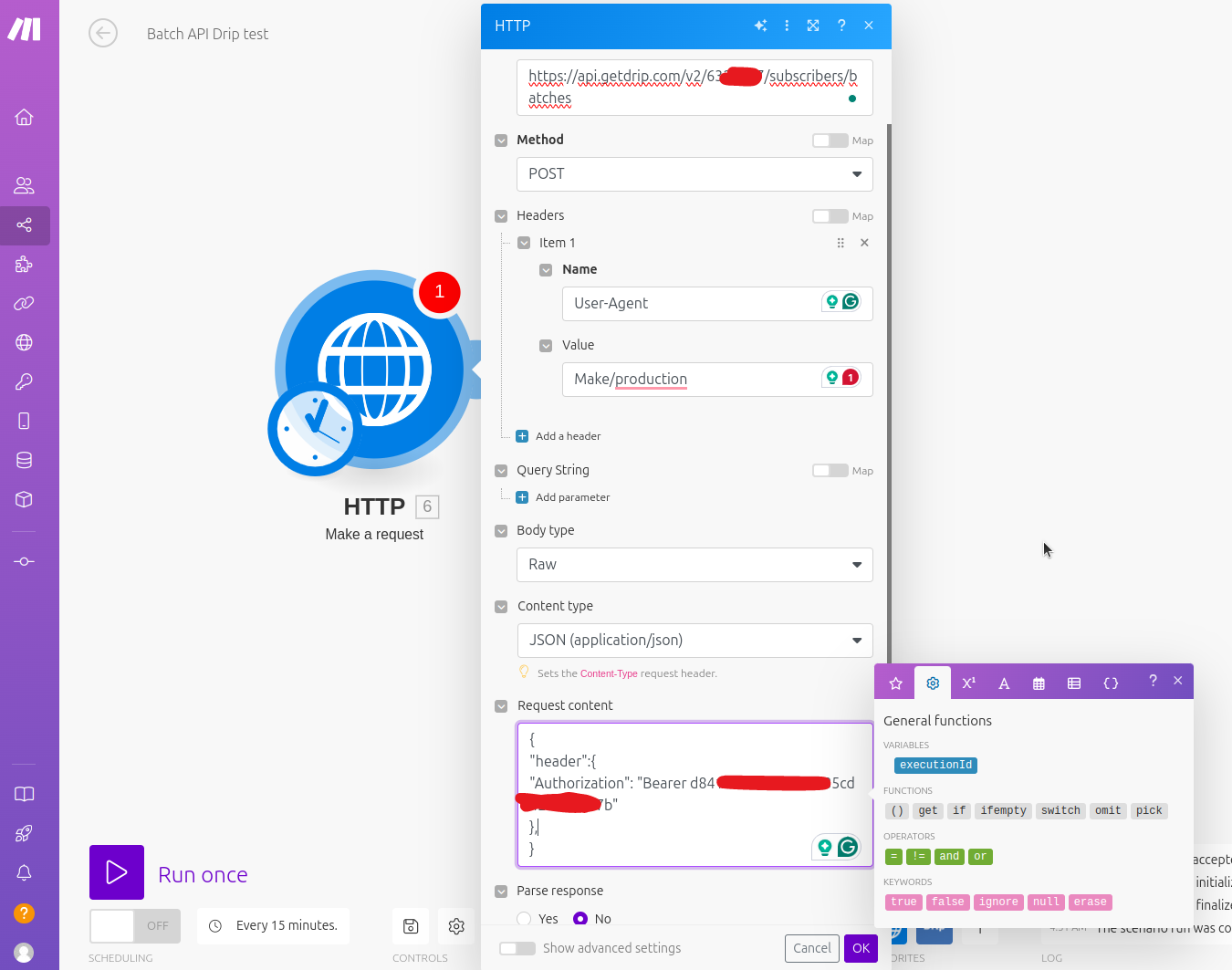

Hello Community,
I'm in the process of selecting a new CRM for a client, and a key requirement is the ability to execute a large volume of tasks using callin.io.
I've come across information that Drip utilizes a batch API, enabling the collection of 50 users in a single API call. I'm curious if this functionality is accessible through callin.io (which would be a significant advantage), or if any callin.io integration operates similarly to other software, where each action on a contact constitutes a single API call.
  • Additionally, I'm seeking recommendations for a CRM that would integrate well with the following stack: [WordPress - callin.io - Airtable - WP Fusion]. We are targeting medium to large-sized companies.
    P.S.: We are looking for a solution to migrate away from Keap (formerly Infusionsoft).
Posted : 19/08/2024 5:55 pm

Hello,
My question is: Are there scenarios where the batch API can be utilized by callin.io to send 50 contacts in a single API request? If so, what are those scenarios? Could it be a scheduled scenario or a webhook?
Posted : 20/08/2024 7:40 am

Hello! Imagine I've set up lists in my Drip CRM, where contacts are stacked based on the actions I intend to perform (Post, Get, Delete). Once a list reaches 50 contacts, the flow in callin.io would initiate, passing those 50 contacts in a single API call using the Batch API from Drip. How would you configure the HTTP module in callin.io to transfer the data for a specific list?

E.t
 E.t
(@e-t)
Posts: 4
Active Member
Topic starter
All good, thanks!
I figured out my mistake, and hopefully, this helps someone else later:
The "Authorization" header needs to be correctly encoded for Drip's API using Basic Authentication (Base64). You can use this Converter to do this.
Posted : 29/08/2024 11:52 am
