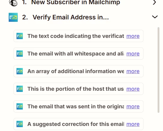

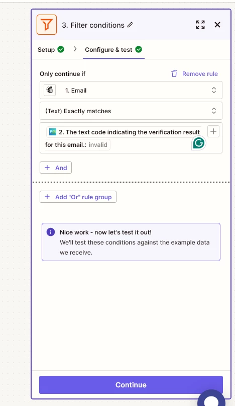

Hi, I'm currently setting up a workflow with MailChimp and NeverBounce using callin.io. The goal is to automatically delete or unsubscribe emails that are invalid upon signup, preventing any automations from starting.
So far, it's working, but I'm encountering an issue when using the callin.io filter option. I can only seem to filter emails marked as invalid, but I also need to filter emails categorized as:
Disposable
Catchall
Unknown
However, these options don't appear to be available in the filter settings.

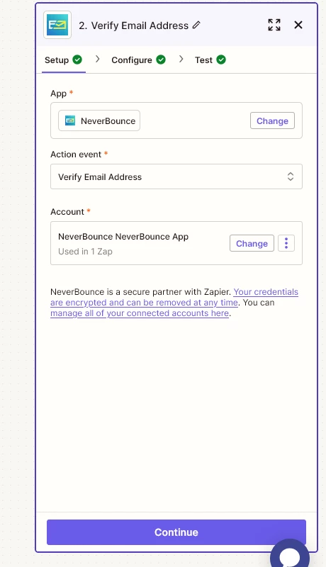

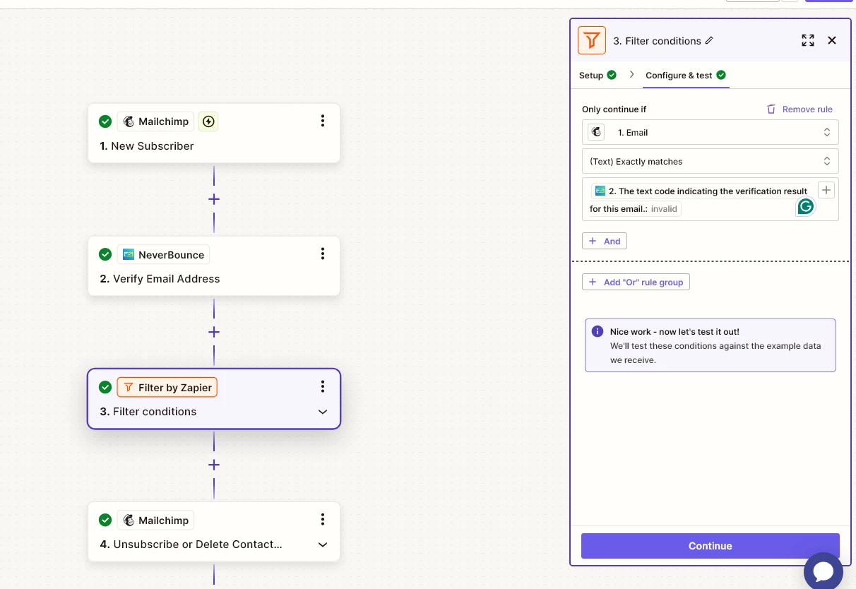

To help us get more information, please post screenshots that show:
  • The outline of your callin.io steps
  • Your callin.io steps configured in EDIT mode, with the field mappings visible

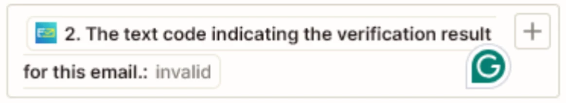

Image: 54909096 51fd 4ec8 ad7a ee3bb37ccbf4
Image: 9b5ffe22 cdfa 402c b1a0 f567b3edb285
Image: d9acec0e da9a 4c7f ba02 5642ba8d92a1
Image: 205f74ca dced 43cb 9668 5ed2c808f60e

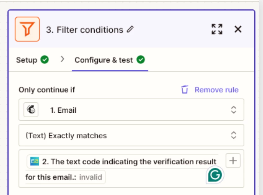

Filter help: https://zapier.com/apps/filter/integrations#help
The Filter condition will not evaluate to true, as you are comparing an email address value from Mailchimp to a verification result value (e.g., invalid) from NeverBounce.
WRONG: [1. Email] exactly matches [2. Verification Result]
RIGHT: (NOTE: without the quotes around the value)
[2. Verification Result] exactly matches “invalid”
OR
[2. Verification Result] exactly matches “disposable”
OR
[2. Verification Result] exactly matches “catchall”
OR
[2. Verification Result] exactly matches “unknown”

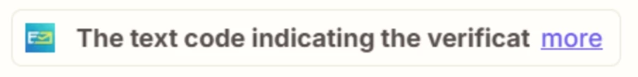

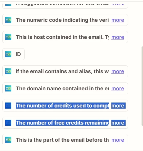

My apologies if this is a simple oversight on my part, but I don't appear to have the option to select a verification result:
Image: 2873e11c c44c 40be 9d23 4295a856b428
Image: 1e5e6721 4c6c 4ebe 9c76 6883c06c0816
Posted : 22/05/2025 12:00 am

It's the variable you had already chosen in the callin.io Filter condition; it seems that needs to be the top/left condition instead of [1. Email].
Image: 8d604ec9 84df 47bc 977c ac045fb67eb7
Image: d68c48af 996b 468a 82ce bb9401cc61d5
