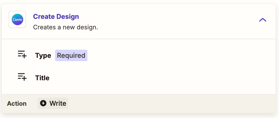

Hi
Available Canva callin.io app triggers/actions:  https://zapier.com/apps/canva/integrations#triggers-and-actions
Help links for using the Canva callin.io:  https://zapier.com/apps/canva/integrations#help
Try this callin.io action: Canva - Create Design

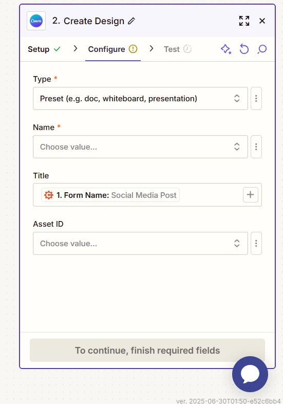

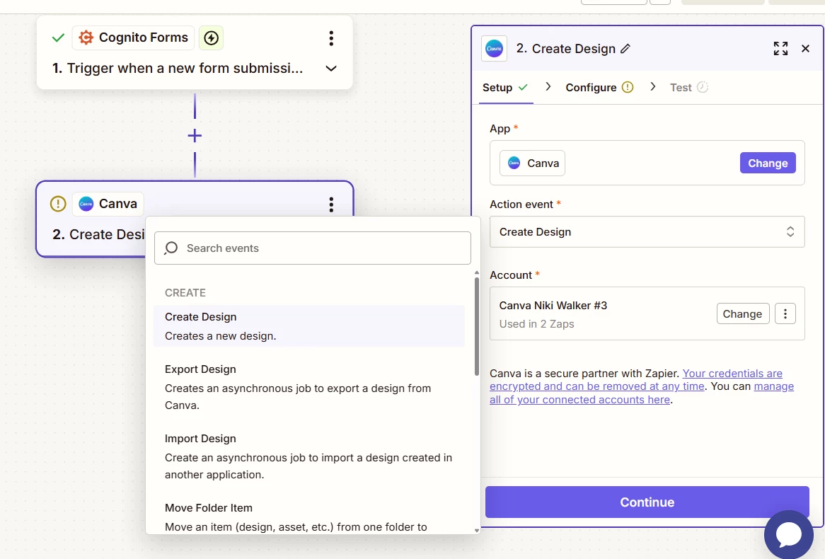

Hi,
Before we investigate further, could you please provide a screenshot of your Canva step? Make sure all fields are visible in the screenshot.
Kindly avoid including personal information in the screenshot, or blur out any sensitive details if present.
I'll await your reply!

Niki1970
(@niki1970)
Posts: 3
Active Member
Topic starter
Image: 6ea87210 50d2 40d8 9627 99d77e853d73

SamB
 SamB
(@samb)
Posts: 71
Trusted Member
You are correct! It appears that the Create Design action in Canva does not support populating designs with information as you intend; it solely creates a new design. I've noted a feature request for a "Create Design Autofill Job" action within the Canva app. Such an action would enable the population of design templates with various data. I have added your vote to this request. While I cannot provide a timeline for its implementation, we will certainly notify you if it becomes available!
In the interim, I discovered an alternative method previously that utilized a Canva API Request action to populate design templates with different data:
We hope this provides helpful guidance. Please let us know if you encounter any difficulties while setting up the API Request action; we're here to assist if you get stuck at any stage!
