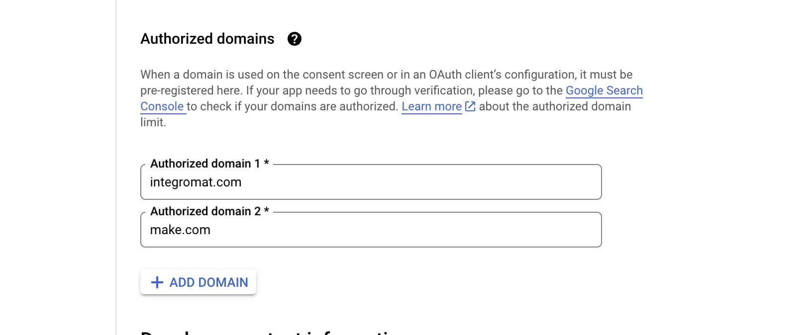

3a. Insert Two Authorized Domains
  • Enter callin.io and callin.io

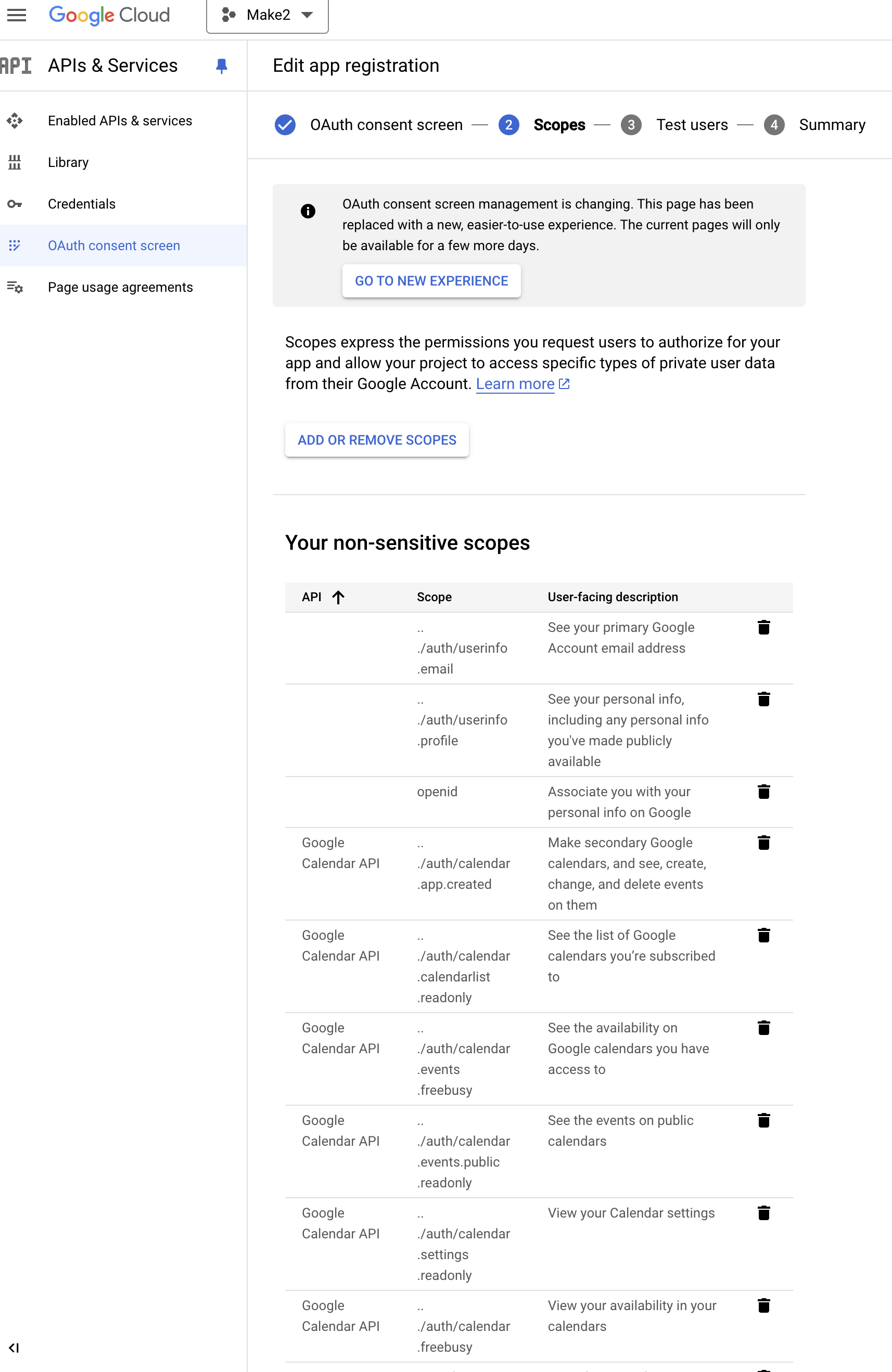

3b. Add All Scopes
  • Click “Add or Remove Scopes”
  • Set “Rows per page” to 100. For each page, check all the rows, OR
  • Manually input the scopes you require
  • Click “Update” at the bottom

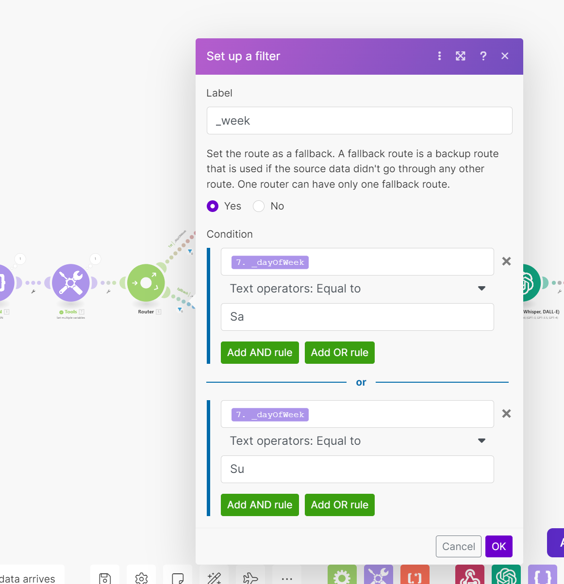

BotGenius_Ai
(@botgenius_ai)
Posts: 2
New Member
Topic starter
Hello,
I wanted to let you know that the previous error I encountered has been resolved. However, during my current testing, I've noticed that the information seems to halt at the tools module. It appears the workflow isn't proceeding past this point.
Could you please help me figure out why the data isn't being passed to the subsequent module and how to fix this issue?
Thank you in advance for your assistance.
Best regards,

I am also encountering the same issue with Google Calendar and have attempted all suggestions from this thread and others, but none have resolved the problem. I'm unsure about the root cause.
I have followed this guide to the best of my ability: https://www.make.com/en/help/app/google-calendar#create-and-configure-a-google-cloud-console-project-for-google-calendar
  • Create a Google Cloud Console project for Google Calendar
  • Enable APIs for Google Calendar
(refer to the screenshot above)
  • Configure your OAuth consent screen for Google Calendar
  • Create your Google Calendar client credentials
I am utilizing the redirect URI ( https://www.integromat.com/oauth/cb/google/ ) as directed in the referenced callin.io guide. I've tried alternative URIs, but they result in an immediate error upon attempting to establish a connection with Google (a 400 URI mismatch error). Using this specific URI permits the connection, but after establishing it, I receive a 403 Insufficient Authentication Scopes error when the module is executed.
Finally, I have deleted and re-established the connection multiple times to ensure a complete refresh, without success. Each instance involved copying and pasting the Client ID and Client Secret directly from the Console.
Posted : 06/11/2024 5:41 pm
