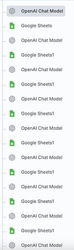

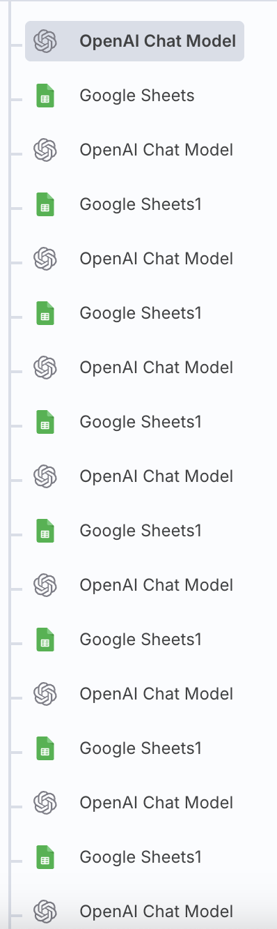

I'm encountering the same issue and haven't found a solution yet. My current workaround involves having the AI report after each individual step. Here's the prompt I'm using:

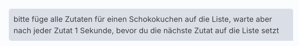

For me, instructing the AI Agent to pause for 1 second after each input proved effective. However, this approach is somewhat unreliable and results in calls to the ChatGPT API after every entry.

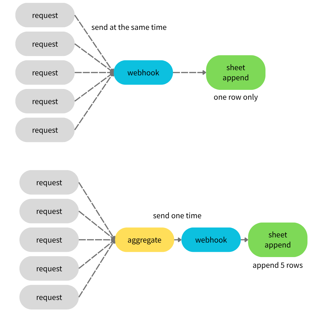

Here's my testing on this topic.
Just resolved another client's issue yesterday.
If there is a service call to Google Sheet that appends multiple times almost simultaneously, the problem will occur, with only one row being appended.
For an AI Agent, I believe we need to instruct it not to append multiple times.
Let it collect all the results and then append them once with multiple rows.
