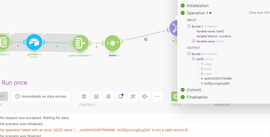

However, I'm facing an issue where some record IDs appear empty in both the Array Aggregator and Set Variable modules. This prevents me from linking all the intended Skills records to the Employee record.

The Update Record in Airtable action is returning the following error: Operation Failed with error

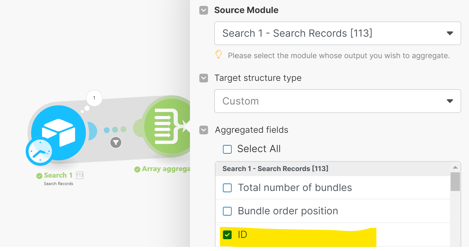

Hi there. Welcome. I've set up a similar scenario and was able to achieve your desired output. Please follow these steps and let me know if you have any questions.
  1. Search your Airtable base for the necessary records using a formula.
  2. Filter between the Airtable search results and the array aggregator to prevent empty record IDs.
  3. Aggregate all record IDs from Airtable using the ID field.

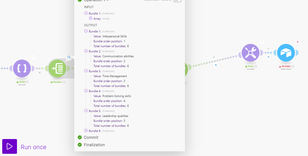

Hello! I'm encountering an issue where the Record IDs are not being written during the update process in my callin.io workflow. Could someone please point out where I might be going wrong?
  1. Overall Workflow
    2.Get the output from parse json
    3.iterator over the parse json
  2. Search with table which specific skills matches and get the IDs

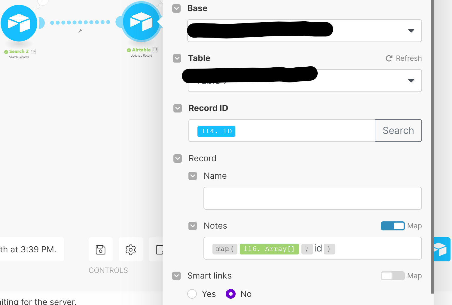

  3. Pass the ID to Set Variable to get the IDs using
    {{map(135.array; “id”)}}
  4. Getting the Error While updating the Airtable Record ID

It appears that you still have empty values in your variable. Try filtering them out before setting the variable with the array of IDs. If this solution doesn't work, could you please share the input where you're placing the IDs?
