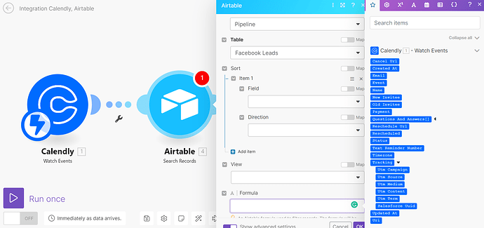

Hello, I'm setting up an automation to retrieve a record from Airtable using either an email address or a name. Could someone guide me on how to achieve this?
Posted : 07/10/2022 5:51 pm

You'll need to create an Airtable formula to identify the specific records you're looking for. Based on your example, you could use:
"Email"={email}
or
"Name"={name}
This assumes your Airtable fields are named 'email' and 'name'. You should drag the Calendly field you intend to use for matching, enclose it in "inverted commas", and then use curly braces around the name of the Airtable field you are matching against. This will find all records in Airtable that correspond.
The Airtable Search module provides an array of Airtable records, which you can then utilize in subsequent steps of your workflow.

You can overcome these types of problems by converting your available values to lowercase (or uppercase, if you prefer).
lower({email})
This action will convert the string value in your Airtable email field to lowercase. By applying this consistently, you will be able to match email values irrespective of their casing.
