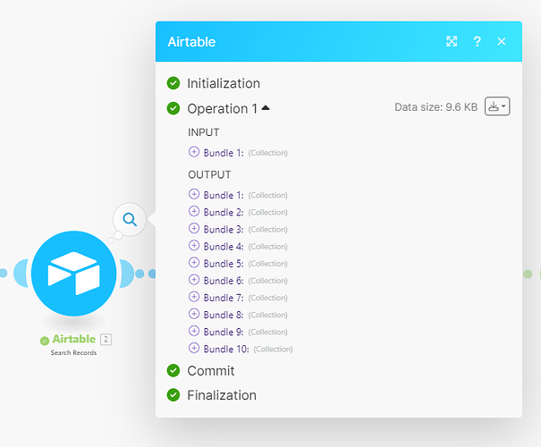

  • I have a query on an Airtable table that returns multiple record IDs (see screenshot; callin.io refers to these as bundles. In the example, 10 Airtable records = bundles are correctly found).

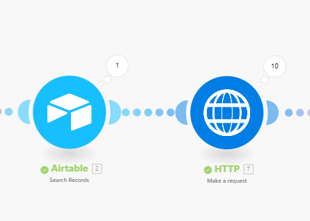

  • Next, I need to query an HTTP GET request (see screenshot 2) for each Airtable ID found. The restriction on the HTTP URL I'm using (a free stock quote API) is a maximum of 5 requests per minute. How can I implement a delay between each HTTP query so that only 5 HTTP GET queries are sent per minute? For instance, in this scenario, 10 Airtable records are found, meaning the subsequent HTTP queries must be executed over 2 minutes (as the maximum is 5 per minute). Is there any other way to solve this? Thank you!

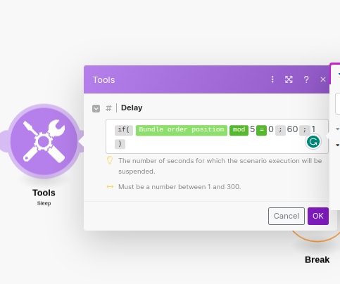

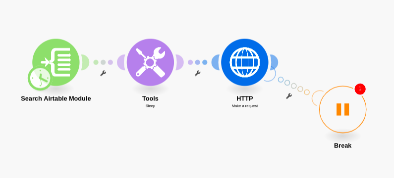

In addition to the suggestions provided, an alternative approach is to utilize the sleep module without an iterator. This method allows for a 1-minute delay for every 5 bundles processed.
You can configure it as follows after your Airtable Search Module:
Screenshot from 2023-06-08 12-19-46
In the screenshot above, the Iterator Module corresponds to your Airtable Search Module. Therefore, you can place the sleep module between the HTTP and Airtable modules. For added resilience, consider incorporating a Break module within the HTTP module. This ensures that if an error occurs due to rate limiting, the process will resume from the point of failure.
