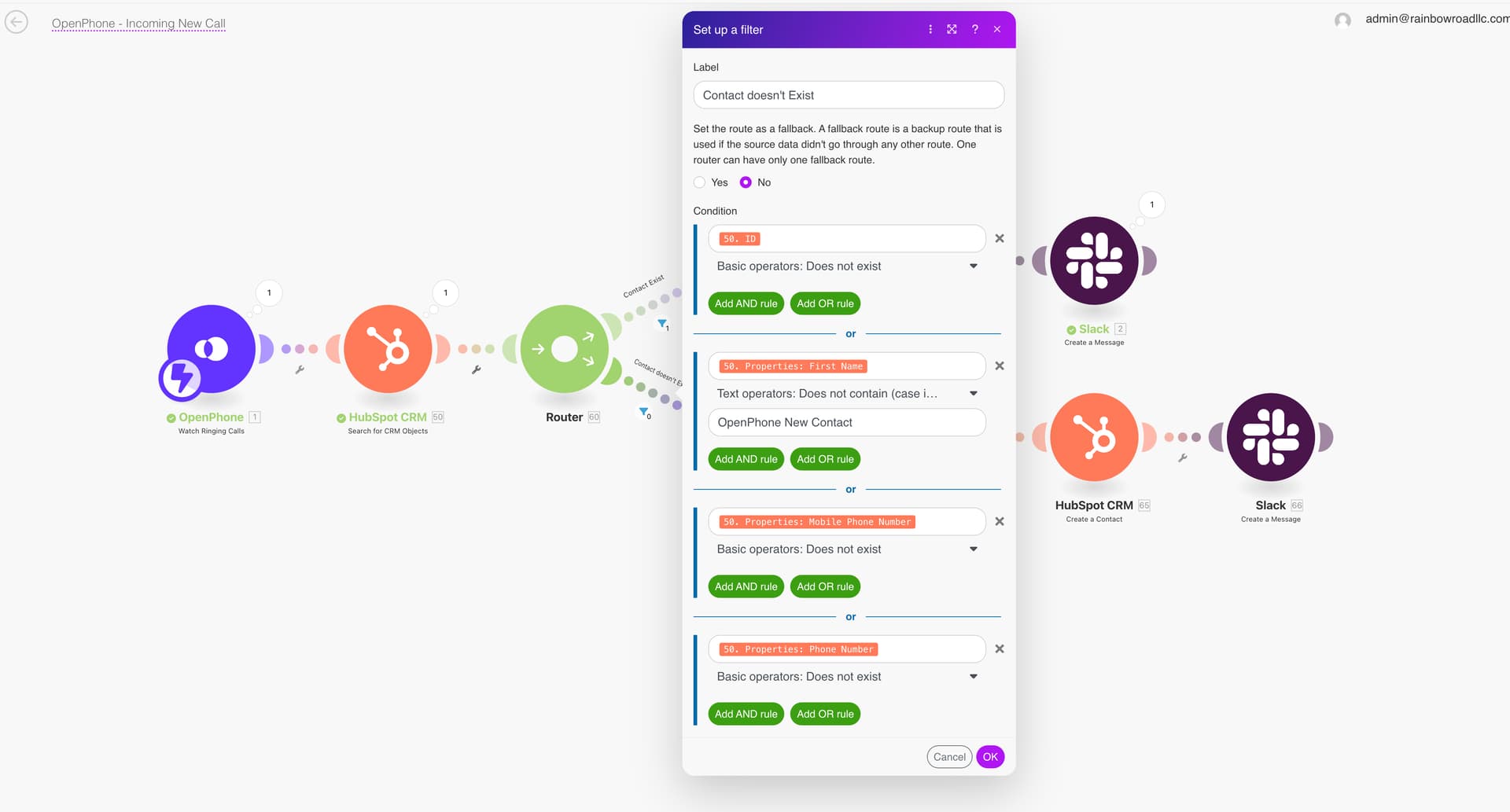

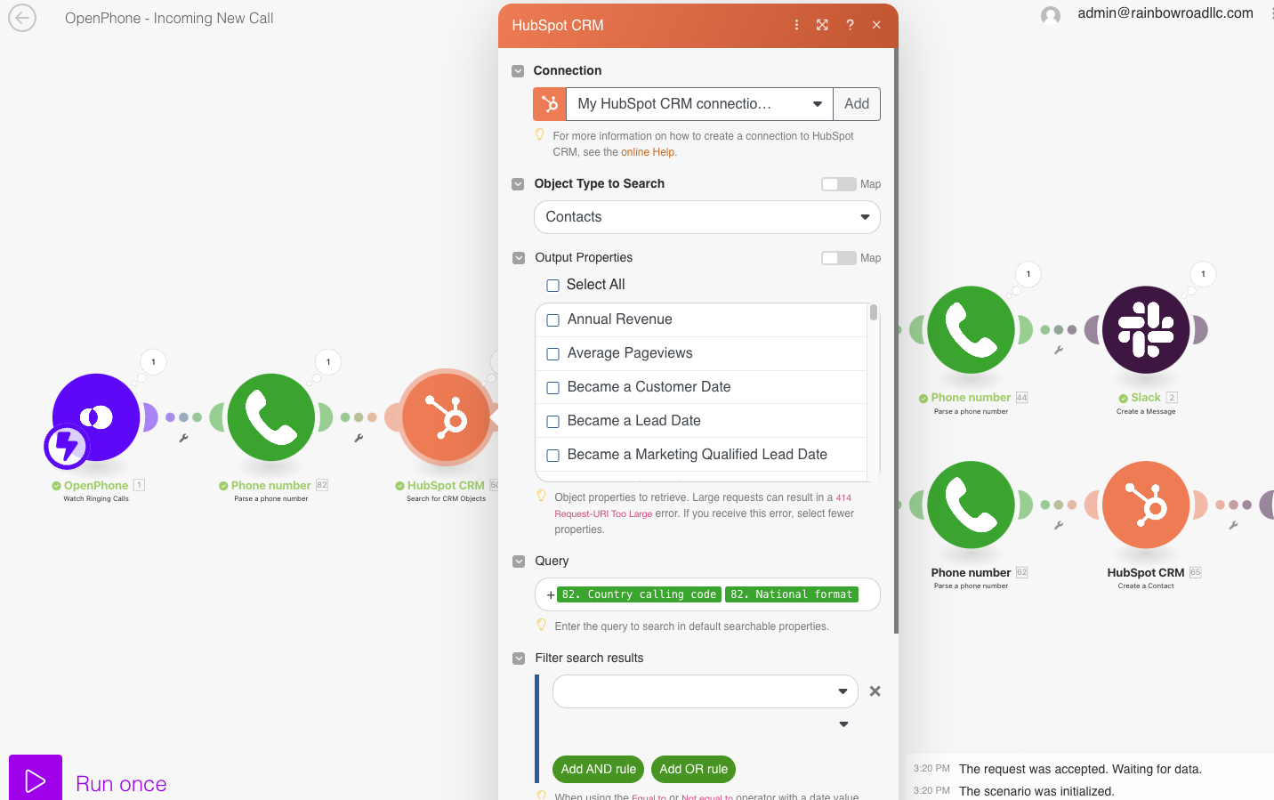

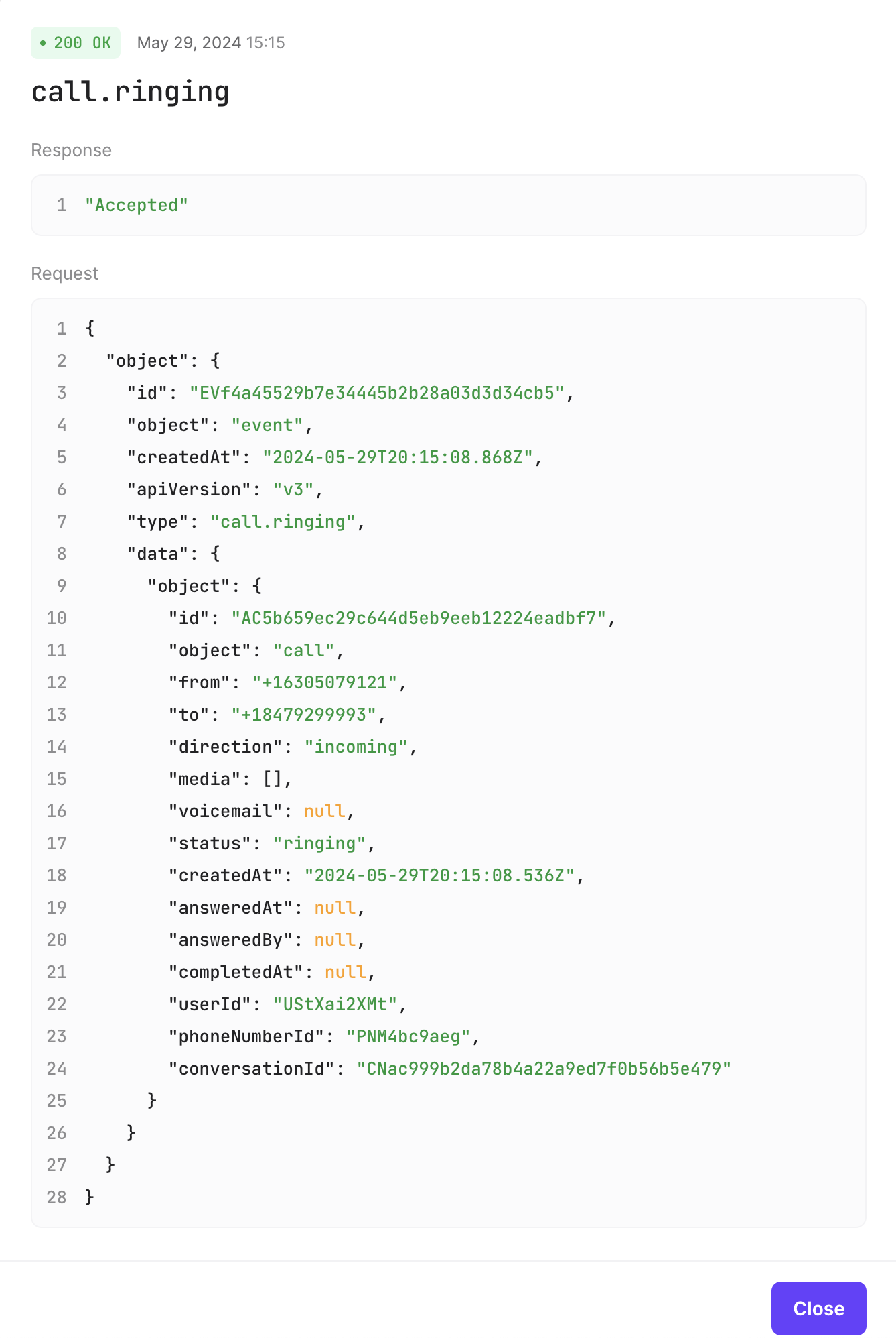

Here's an example of a duplicate contact that was created after a person called and selected an IVR option during the same call:

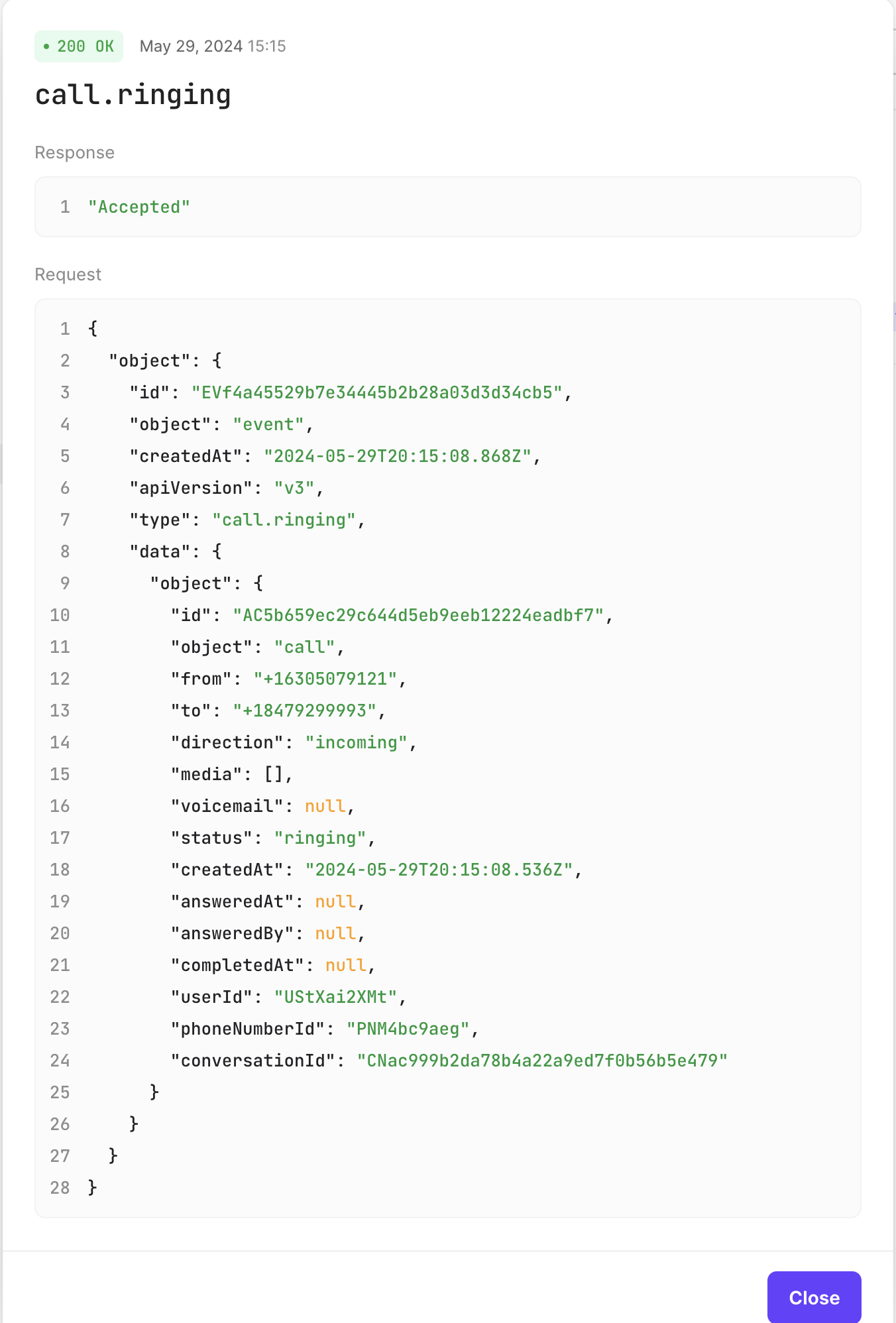

Here are the OpenPhone webhook details:
Main Line: Triggers when a person dials our number:
It will trigger again when you select an option on the IVR:

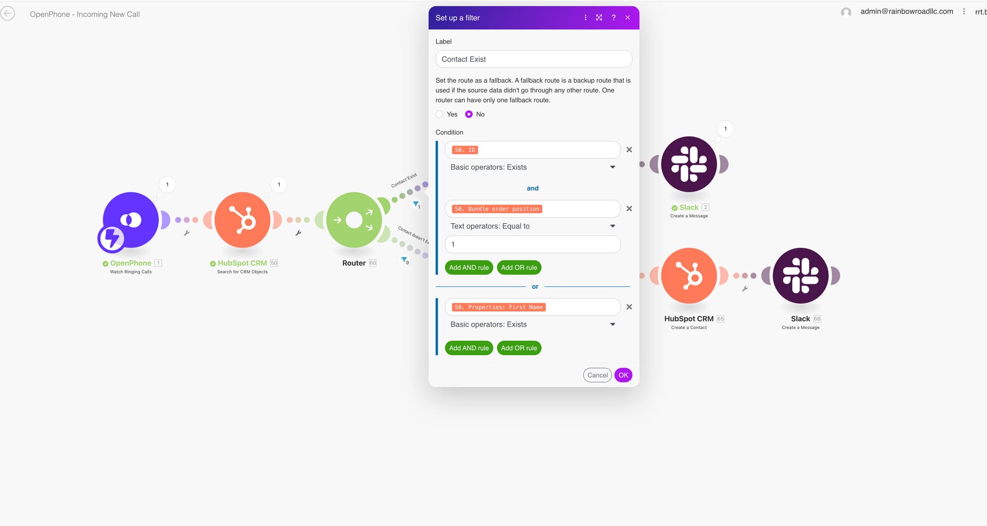

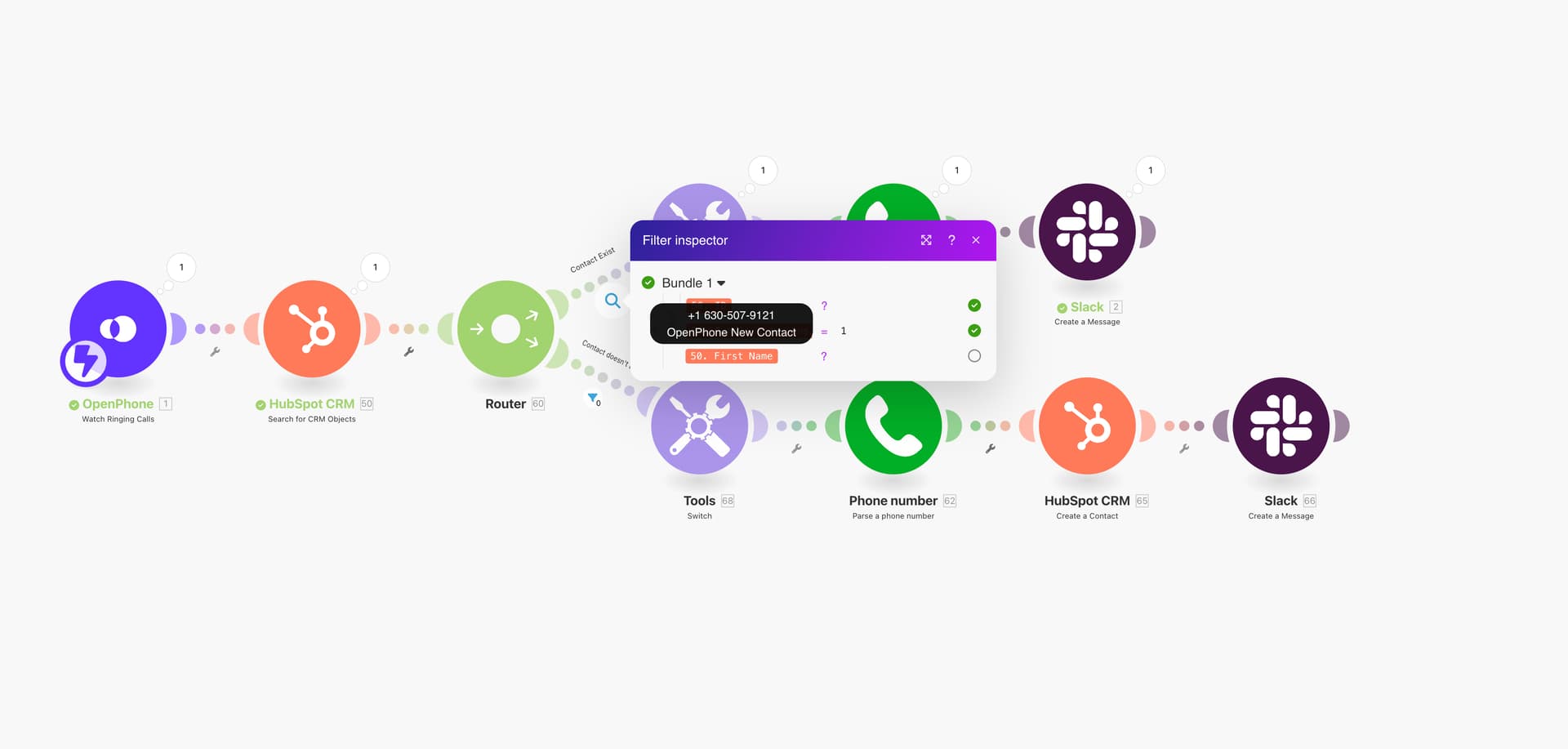

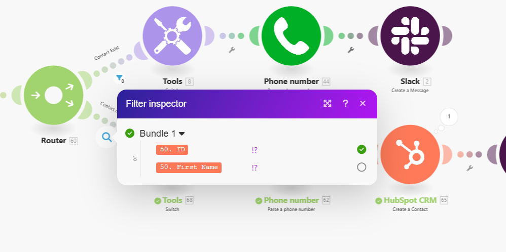

Here is my filter:

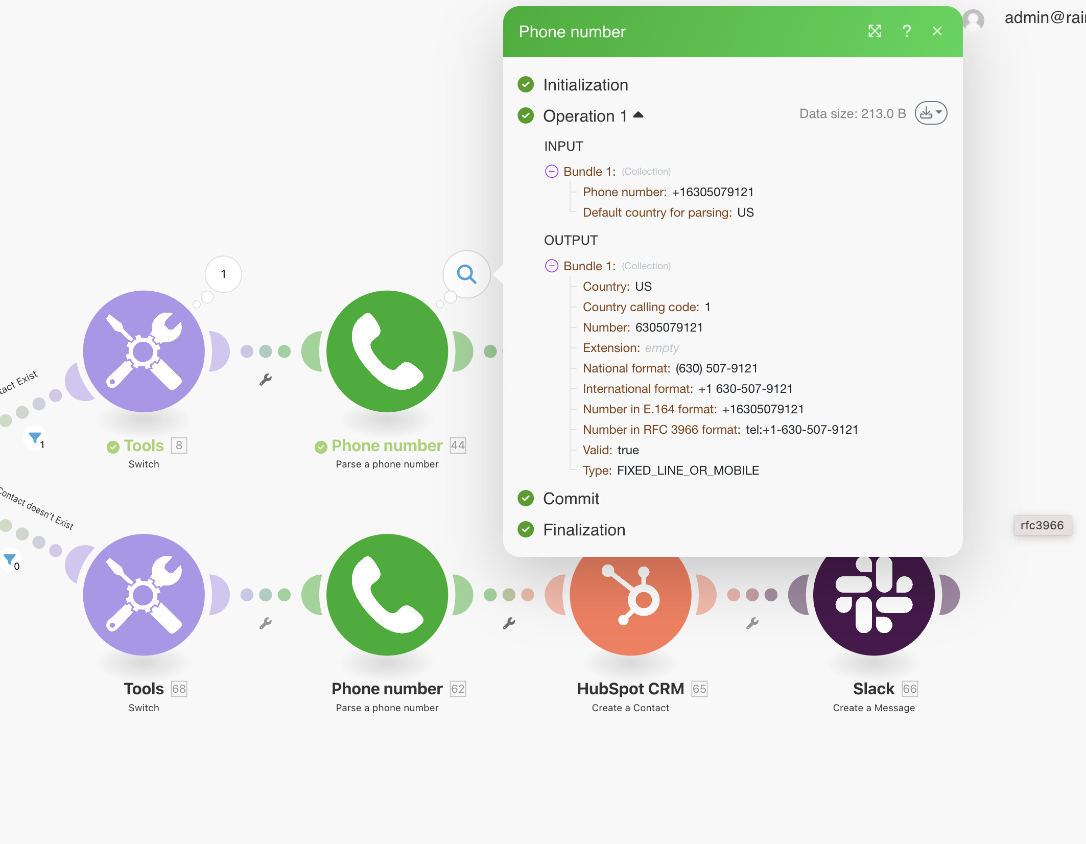

I discovered that when a caller is added to HubSpot for the first time, it saves the mobile and phone numbers using the phone number parser:

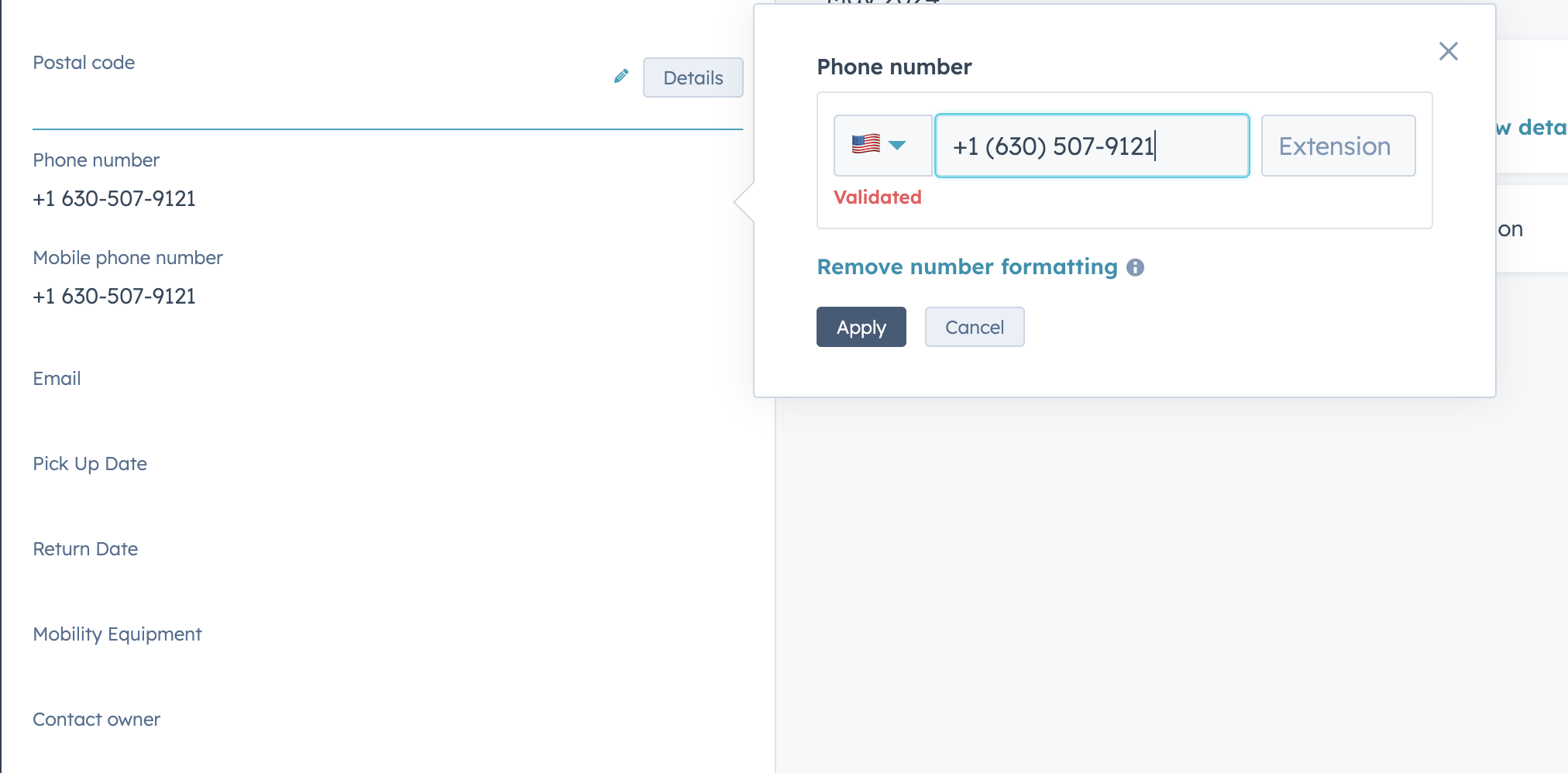

It saves like this in HubSpot:
However, I need to manually go into the HubSpot record and format the number to a US number. Only then does it filter as "CONTACT EXISTS".
After saving it in HubSpot as a US number, it processes as a contact existing:
Here is my blueprint:
OpenPhone New Call Blueprint.json (305.9 KB)

There are many components involved here.
One approach could be to check if the scope of the OpenPhone trigger module can be updated. See if you can configure it to not activate on initial calls, but only when an IVR selection is made.
Alternatively, consider using the Phone Number parser immediately after the OpenPhone trigger module. Then, reformat your number to include parentheses around the area code. Format it like this:
+{{Country calling code}} {{National Format}}
Subsequently, query HubSpot with this formatted number and add the contact if it doesn't already exist.
Posted : 30/05/2024 3:21 pm

However, there's another issue. For those contacts, I edited the phone number in HubSpot to a US format, but now it's showing as non-existent because the phone number format differs from the parsed number.
Is there a way to query two different formats? Similar to what's shown in this screenshot?
Posted : 30/05/2024 9:13 pm

I don't have enough experience with HubSpot to be certain, but I suspect the answer is no.
You might consider expanding the search query or leaving it empty and utilizing two "Filter search results" nodes with an OR condition.
Alternatively, if HubSpot doesn't find any matches with one search version, you could employ a router to search again using the alternative phone number version. If that also yields no results, then proceed to create a new contact.
Posted : 30/05/2024 10:15 pm
