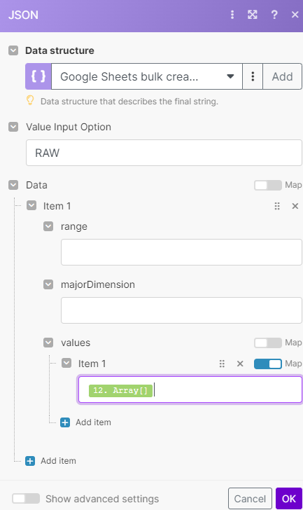

I am encountering difficulties in aggregating the CSV data into the values array in the correct format: an array for each row, with each value within it.
I have mapped the array aggregator to the data element in the JSON object, and it is outputting the items into the values attribute:
However, this results in multiple data elements in the JSON, each corresponding to a row, and they all target A:W, leading to the same row being repeatedly overwritten.
:frowning:
The JSON object I have constructed appears like this:
If I set the array aggregator to Custom, the output at this stage cannot convert the associative array into text elements. If I use collection, the data passed to the callin.io API is not in the correct format:
It seems I should be attempting something like this:
However, I am unable to figure out how to correctly map that array into the values field.
It appears I'm missing a crucial step in achieving this conversion. Does anyone have any suggestions?

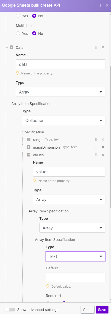

In the actual data, there are 23 columns, so I'm a bit concerned about the maintainability of a series of nested join/split operations if more columns are added in the future.
However, you've just shown me that I can copy and paste JSON to and from the scenario editor. This has allowed me to rapidly auto-generate some definitions within a macro environment.
I've managed to set this up now:
It's still a bit complex, as there are a couple of nested replace operations to handle newline characters and quotation marks within a Text constructor:
This is then assembled into some text as valid JSON:
And then parsed against a JSON description:
The JSON used to create the schema was:
"values": [
["one","two","three"]
Then, the JSON can be created:
And finally, calling the API with that:
It's a bit more involved, but perhaps more manageable than the join/slice method?
Posted : 02/05/2024 2:22 pm

You can place 20 directly into 21’s JSON field, which avoids an extra operation.
Posted : 02/05/2024 2:32 pm
Michael_Jervis
(@michael_jervis)
Posts: 6
Active Member
Topic starter
When I attempted that, I encountered an escaped string literal that was incompatible with the final API payload. For an unknown reason, including that string directly failed, which led me to parse it into a JSON object and then utilize that. It wasn't quite the outcome I had anticipated.
Posted : 03/05/2024 7:11 am
