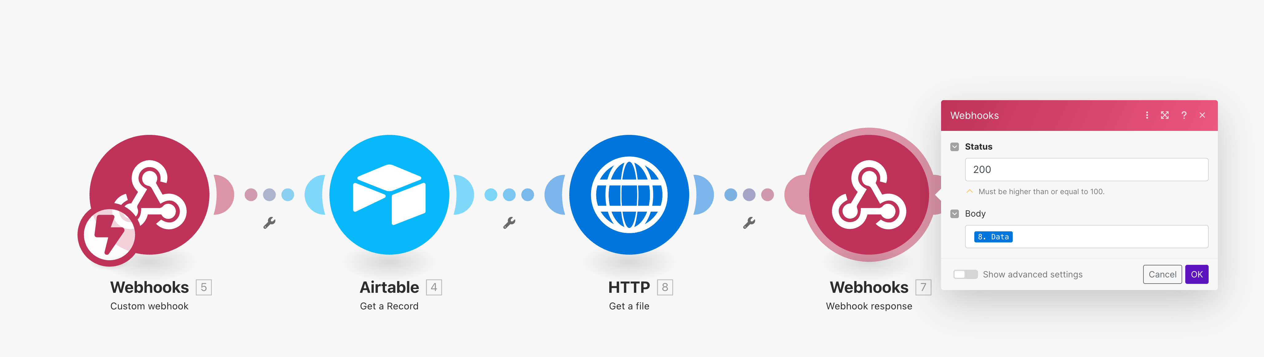

Hi Alex,
Airtable attachments can present challenges. It's uncertain if the text file is accessible via a permanent link, but when we need to store Airtable attachment links, we typically implement an additional layer. This involves sending a webhook URL along with the record ID to an external system. This webhook is connected to a straightforward scenario that functions as a file link.
Thanks, Anton

Hi Alex,
The issue stems from the inability to reconstruct Airtable attachment URLs (refer to this link).
Best regards, Anton
