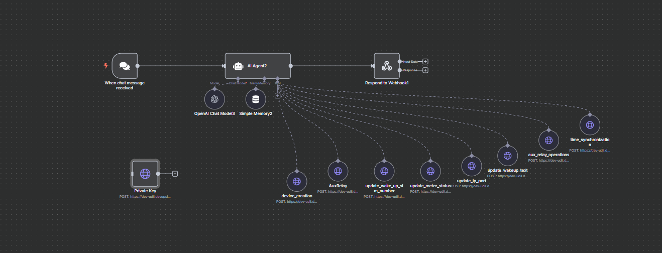

Hello team,
I'm currently developing a workflow using callin.io's AI Agent with Langchain and HTTP request tool nodes. My objective is to dynamically inject a privatekey obtained from an authentication request into the headers of subsequent tool API calls, but I'm encountering some difficulties.
:light_bulb: Goal
When a user selects a tool (e.g., update_meter_status) via the AI Agent, callin.io should perform the following:
  1. Invoke the authorization_service to retrieve a privatekey.
  2. Include this privatekey within the headers of the actual tool request.
  3. Ensure the authentication node (specifically for Private Key) is not displayed in the AI's tool selection menu.
:test_tube: What I’ve Tried (and why it failed)
  • Direct expression:
    ={{ $node["Private Key"].json[0].privatekey }}
    :small_orange_diamond: Fails unless the node has already been executed, resulting in an `undefined` or `unexecuted` error.
  • Inline `$http()` in expression:
    ={{ $http({...}).json[0].privatekey }}
    :small_orange_diamond: Not supported, as `$http` is not permitted within expressions.
  • Merge node:
    Attempted to combine AI input with the Private Key before the tool call.
    :small_orange_diamond: Does not trigger both branches; the second input typically remains unexecuted.
  • Code node to combine data:
    Manually merged the inputs.
    :small_orange_diamond: Encountered the same issue where one branch remains unexecuted.
  • Renaming node as `_internal_` to hide from menu
    :small_orange_diamond: The node still appears in the AI tool list.
:counterclockwise_arrows_button: What I’m Looking For
  • A method to automatically execute an internal authentication node prior to any AI-selected tool being invoked.
  • The ability to keep this authentication node hidden from the tool menu.
  • The capability to reuse the obtained privatekey in all subsequent HTTP headers.
Are there any straightforward solutions for this pattern? Perhaps utilizing workflow context, a credentials trick, or hidden pre-execution hooks?
I greatly appreciate any guidance you can offer. I'm happy to share the full workflow JSON if needed!
Thanks
:folded_hands:
