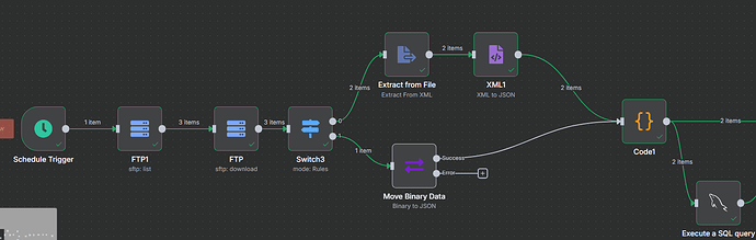

Hello Everyone,
I'm encountering an issue where the second output from a Switch node isn't executing the subsequent inline node. This happens regardless of the node used in the second output. It functions correctly for a few runs and then stops. It does work if I manually trigger the play button on the node. Sometimes, the top path of the flow executes, followed by the bottom path, but this isn't consistent. The node is configured to retry on errors, but this doesn't seem to resolve the problem. I'm concerned about its reliability in a production environment, as I'm building this to process orders.
This is a self-hosted callin.io instance. The only errors are present in the Docker logs, which don't seem to relate to this specific node. The node itself does not report any errors.
node execution output incorrect data Error: node execution output incorrect data at WorkflowExecute.runNode (/usr/local/lib/node_modules/callin.io/node_modules/.pnpm/callin.io-core@[email protected]_ws@8.17.1_zod@3.25.67_/node_modules/callin.io-core/src/execution-engine/workflow-execute.ts:1219:6) at processTicksAndRejections (node:internal/process/task_queues:105:5) at /usr/local/lib/node_modules/callin.io/node_modules/.pnpm/callin.io-core@[email protected]_ws@8.17.1_zod@3.25.67_/node_modules/callin.io-core/src/execution-engine/workflow-execute.ts:1581:27 at /usr/local/lib/node_modules/callin.io/node_modules/.pnpm/callin.io-core@[email protected]_ws@8.17.1_zod@3.25.67_/node_modules/callin.io-core/src/execution-engine/workflow-execute.ts:2157:11

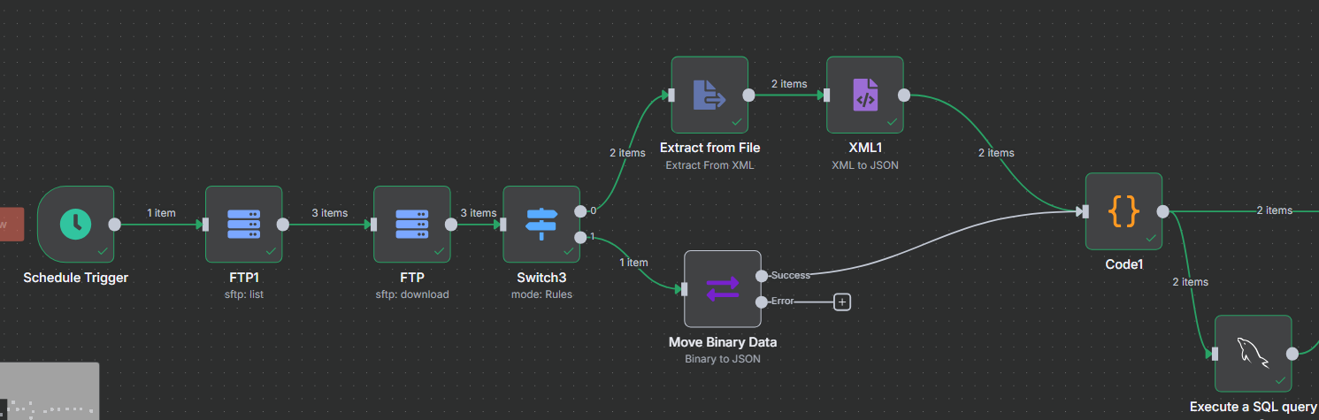

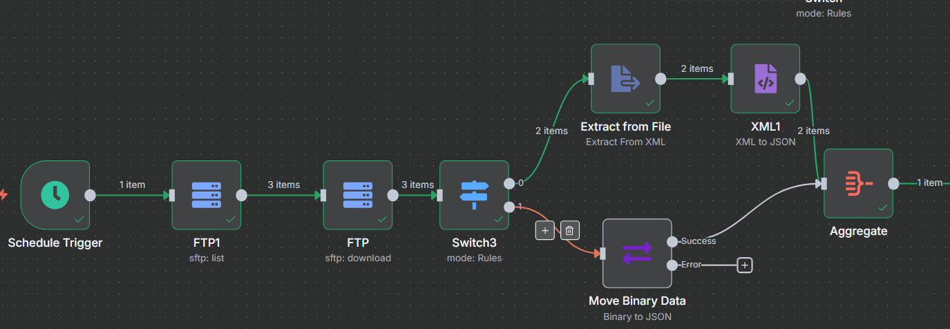

I'm unable to merge them since each item represents an individual order. The file formats are kept separate for conversion to JSON. Additionally, the aggregate node is not needed; I was attempting to get the node to execute but couldn't without manually triggering it.
This is how it was originally configured:

I'm unable to output blank data, but I am encountering output errors. However, nothing is ever logged in the error section. The preceding node, "Switch 3", does output data. The issue is that the subsequent node doesn't consistently process it.

Based on the screenshot, it appears the data from the FTP server consists of 3 files. These files are split at the switch node, with 2 files going to the top branch and 1 file going to the bottom branch. The top branch proceeds to the end, while the bottom branch seems to halt before the Move Binary Data Node?
How does this setup appear?
Posted : 22/07/2025 6:04 pm

That is correct. The top converts XML to JSON, and the bottom converts binary to JSON. The latter is the only one experiencing intermittent issues.
Regarding the errors, I have the output errors selected in the settings, but it never outputs an error when it fails to process the input.

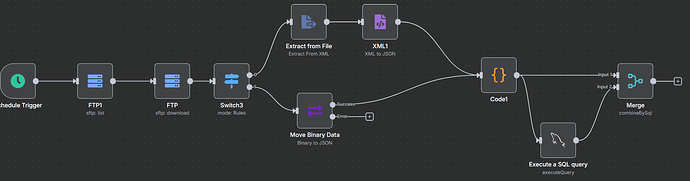

Could you share your workflow by embedding it here? Perhaps I can assist you in getting it to function with the latest version.
Posted : 24/07/2025 12:32 am
Oeq06
(@oeq06)
Posts: 7
Active Member
Topic starter
Posted : 25/07/2025 7:51 pm
