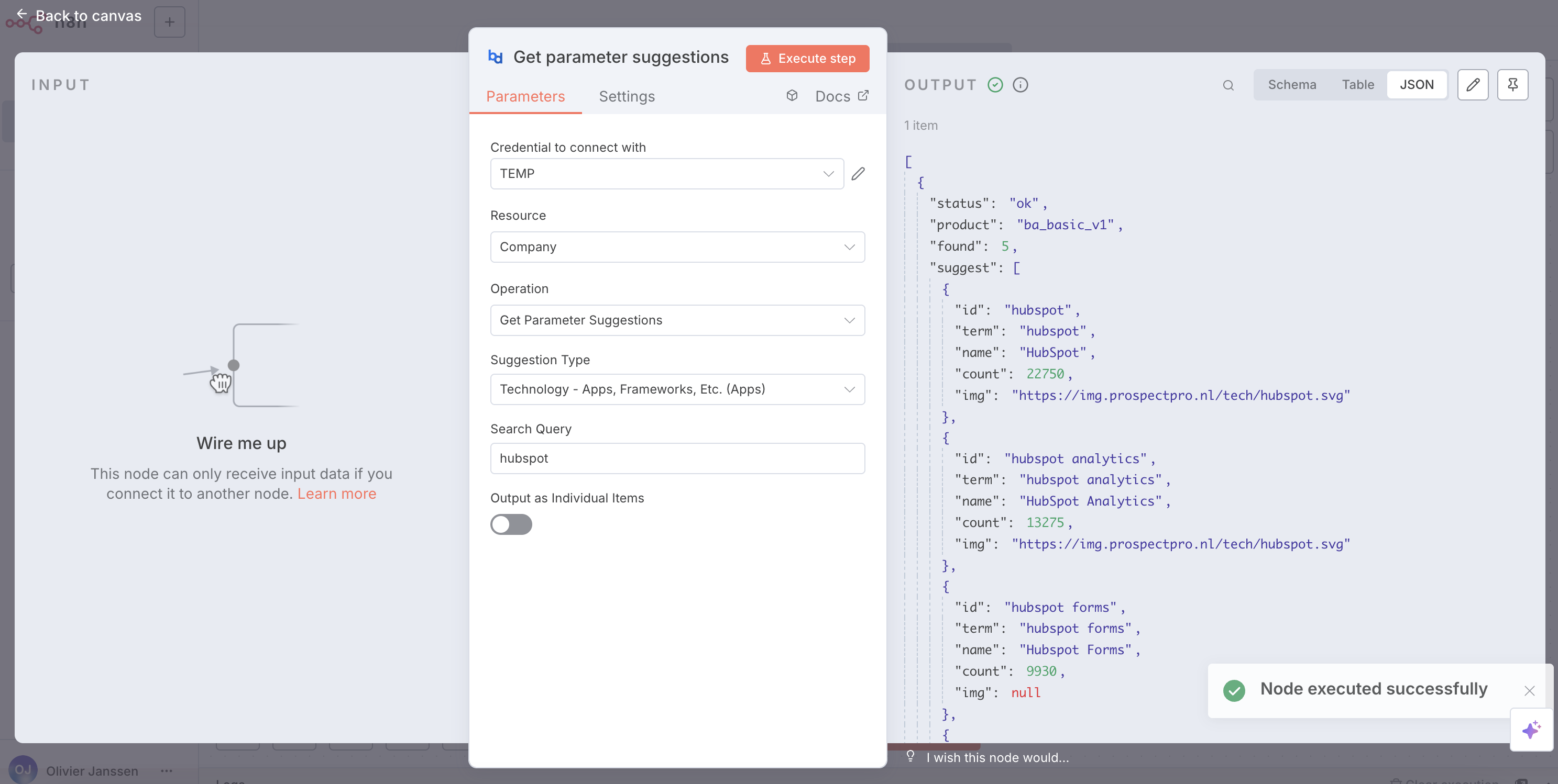

There appears to be a discrepancy when using a node manually versus as a tool:
  • When I utilize a specific node manually, it returns the expected values.
  • However, when using the same node as a tool (and the AI provides the exact same input as I do manually), the results are not being returned to the agent.

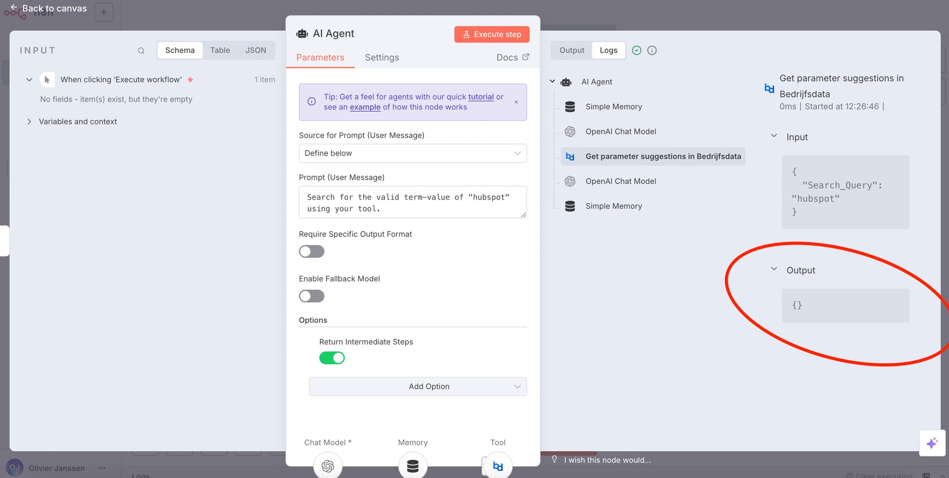

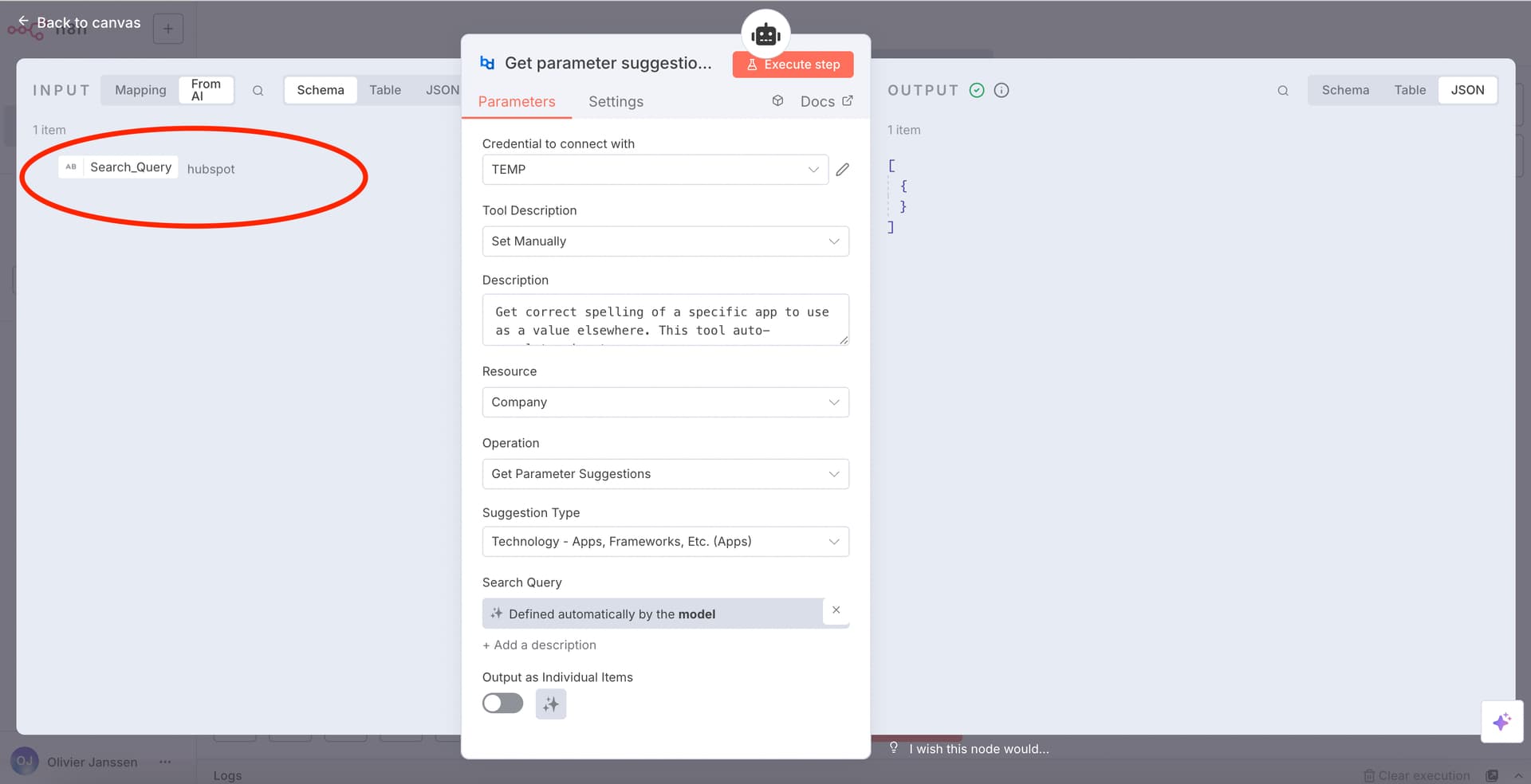

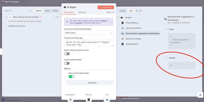

The issue is clearly visible in the “last output” (see below); the “observation” field is empty. I’ve attempted further investigation but haven’t been able to expose any relevant data. It seems the complex JSON returned by the tool is simply not reaching the agent.

Agent log:
Tool log:
Manual usage DOES work as expected:
