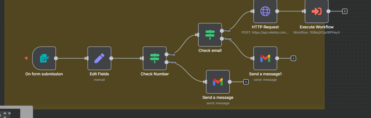

I've set up a workflow using callin.io via callin.io, utilizing a callin.io form for user input.
Additionally, there's a separate webhook workflow designed to capture and record call data.
This setup functions correctly when I initiate a test call or make a call manually through callin.io.
However, when I use callin.io to trigger an API call to callin.io for making a call, the call data isn't being sent to my other webhook; it's simply not receiving the information.
I've attempted numerous solutions and would appreciate any help!
Below are screenshots of the workflows:

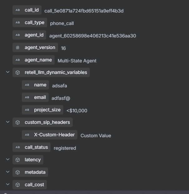

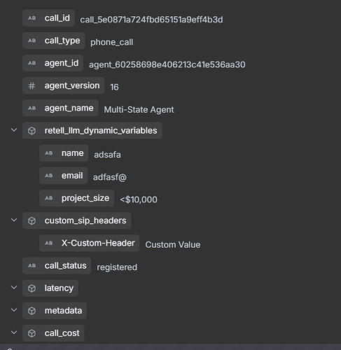

Hello Sir,
I followed your advice and placed the execute sub workflow node after my initial workflow. It successfully transmits the information to the second workflow.
However, the issue is that it's sending "call registered" information, when I require "call analyzed" information.
Please take a look!

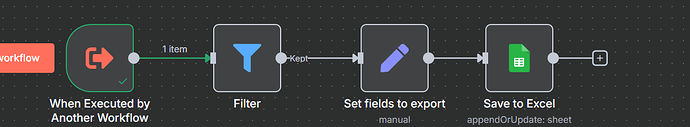

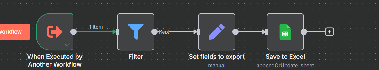

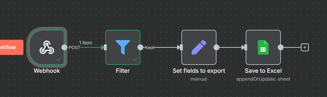

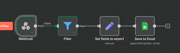

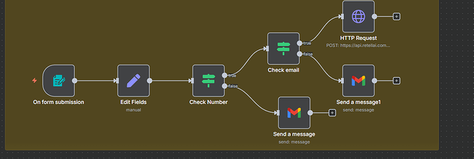

Here are the workflows:
Workflow 1 -
Workflow 2 -
Posted : 23/07/2025 5:15 pm
